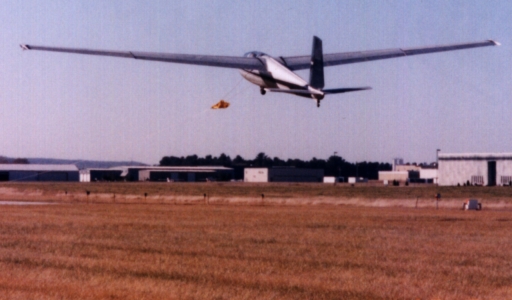

The glider is off the ground after a ground roll of usually less than a hundred feet. The slice of light grey at the left margin is the near end of the paved runway. Note that the glider's pitch angle is safe; if a rope break occurred, a slight nose-down pitch would bring a safe landing a few hundred feet down the runway. Copyright © 2000, 2002 Daniel L. Johnson; all rights reserved.
