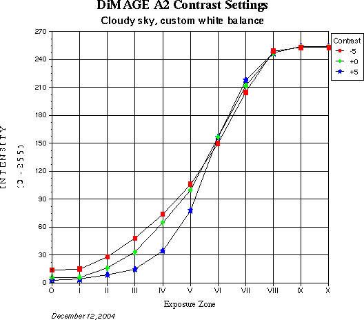

The curve below was obtained by taking three series of exposures at ISO 64 of a standard target.
This set of curves shows three things:
However, if the photographer's main interest is preservation of highlight detail, then the following technique can be used to yield proper exposure:
The natural tendency, for photographers who understand this, is to underexpose to protect highlight detail -- but doing so does not increase shadow contrast or detail, and increases noise in shadow areas. It appears to be a simple fact that digital cameras have little exposure latitude and precise exposure is a really good idea.
My own experience is that having a real-time histogram and taking manual control of exposure is the best safeguard, but when highlight areas are small, their spike may be too small to see in the viewfinder, and then the photographer doesn't quite know how to adjust for them.
In addition, I am finding out that the DiMAGE A2's exposure calculation is not as accurate as I had assumed. This is a reason to bracket exposures of important scenes.
